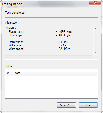

I've read this topic, but i think that my problem is simplier. Maybe it's the same. Where can i get nfo about performed task, how it was in 5.x version:
0_6b8e8_522daba3_L

There is currently no erasing report, as there was in Eraser 5, only error reports. I too would like to see something more like the Eraser 5 reports (though it would be in the log, not in a modal dialog).
