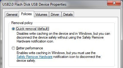

4. Click the Policies tab; you should see something like this:
5. If the first option, Quick removal, is already selected, you're good to go. As noted in its description, "you can disconnect the device safely without using the Safely Remove Hardware notification icon." If Better performance is selected, switch to Quick removal and click OK.
So, what are giving up by disabling write caching? According to the test results posted at 7tutorials, almost nothing. The performance impact was negligible. Your mileage may vary, of course, but I think it's worth a few milliseconds to avoid the hassles of having to mess with Safely Remove Hardware all the time.
